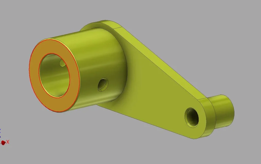

you can make a derivative component using the first option "subsequent lav. style" the first option "solid body joints ....", interrupt the link, use the command "instinct/offset" by selecting the sup. interested in the offset, one by one, and choose the output "surfaces".
in the browser go to the "surface offset1", button dx "object copy", output selects "body" and creates new "composed" (original release).
deletes the derived component and the "surface offset1".
on the "composed1" again apply the "inspect/offset" command, with offset of the thickness and direction that interests you.
Saldato derivato.webpRivestimento.webpI didn't care much, but it works.
Thank you for the suggestion, it is the solution I am adopting, it is a little laborious, indeed
an offset on iam file would be useful.
