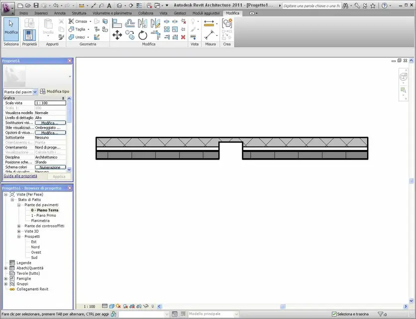

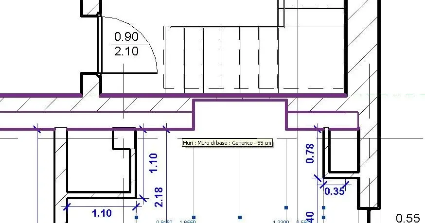

Hello everyone, I have a problem that I cannot find a solution, hoping for your help. I have a wall of 55 cm thick on which I have to make a niche with a thickness of 47 cm. I then modeled a family based on a wall with a solid of parametric subtraction so "digging" the niche in the wall. when they place the vacuum correctly I get the niche on the wall, but the detachment of the same is eliminated in the middle of the wall that houses the niche, while it remains in the other half. Trying and retrying I noticed that this error comes out only for blanks with greater thickness than half the wall (in the case specific for a subtraction solid having a thickness greater than 55/2 = 27.50 cm ). Does anyone know how to give me advice to get the wall back properly?

...I noticed that this error comes out only for blanks with greater thickness than half the wall...
it also happens to me and depends (the fact that it happens or not) on the default screws of the wall for the parameter "fill to the inserts": if it is set on both or on the side on which the niche is placed it happens that the entire wall is displayed incorrectly.
Does anyone know how to solve the problem?
y.
... so dry, divide the wall on the section affected by the niche and remove the fold to the inserts....
insert a vacuum (niche) derived from a family of windows, modified ad hoc...
