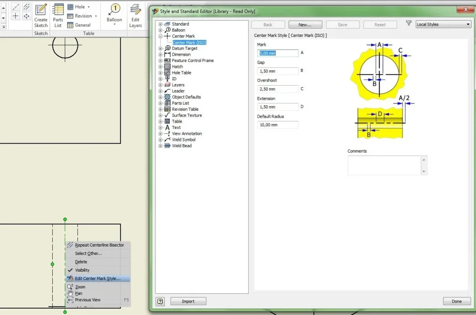

I started from there, but changing those values does not change anything in the lines....and, in fact, this seems strange to me.. .
umh, with that window you can change the lines inserted with the commands of center hole, axis line, bisector etc.

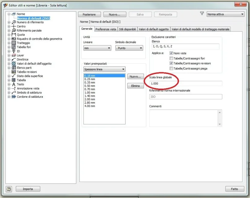

I think you look for this value... you must select the norm. (use 2014, hope is equal)Scala Linea.webp
I think you look for this value... you must select the norm. (use 2014, hope is equal)View attachment 37621
thank you but that's not even what I'm looking for, because as I wrote in the first post, changing the global scale changes all the restraints.
I want to change only the axis ones (too thick), because the hidden lines hold me so well.....
