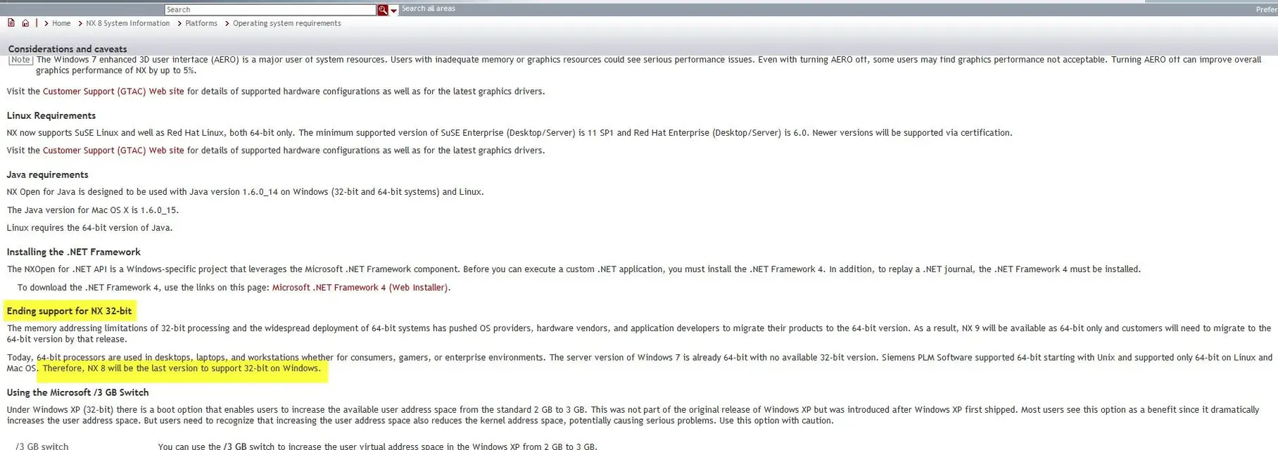

thanks beppe for the info.
I said June because I read that the release period is 12 months.
nx 7.5 was released in June.
for 32 bit support, I based on the nx 8 release notes that I attach.
for precision, nx8.5 will be on October 23.
I think beta testing starts in spring.
Maybe it's good that I clarify something, because I've done a little hard to understand it myself, talking to the manager of the platforms.
- nx7.5 is the latest version developed on wxp-32
- nx8 is developed on w/-64
- nx7.5 is certified on wxp-32
- nx8 is no longer certified, but is supported
this means that in case of problems laced to the platform, the answer of the r&d will be "pass to nx on w7-64".
the same should be (supported, but not certified) for nx8.5
