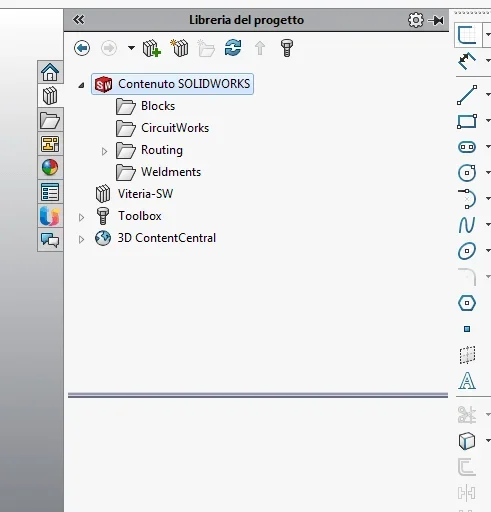

I wanted to ask you how you do the offices for tabs in trees and hubs.
where I worked before we had a number of features for these operations, where I am now using toolbox, but I don't think there is this processing.
Thank you and everyone.
the offices are present in the library features.
openable bread task, go to libraries>design library>features>metric>keyway
libraries are installed by default.
check in system options that the address is included

Right-click on the bread task icon and open it.
are configured functions so you will just open the data table and check/change the values
