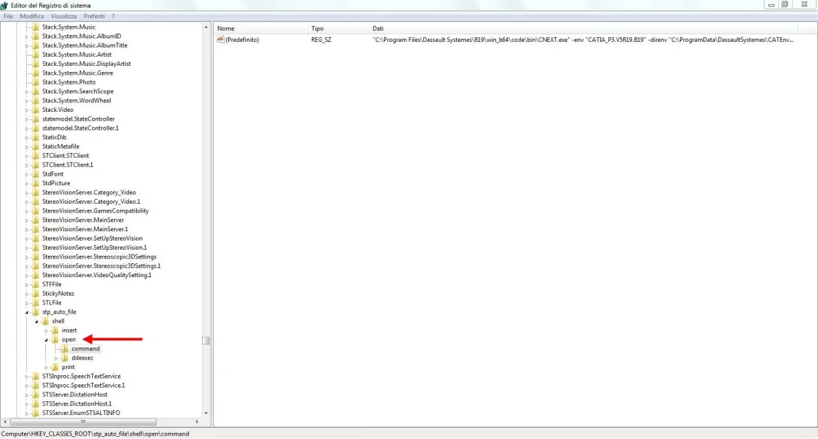

hello to everyone, I'll put the solution to the problem.
you have to go to the registry and delete the 'open' item on stp_auto_file
This way, when you try to open a step, win asks for the program.
just choose caia and the game is done.
thank you all!!! you are always mythical!
