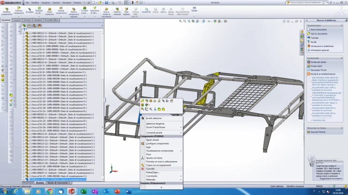

make a screenshot of the file from which you delete the particular and clearly indicate it on the image that I don't want to read a list of over 100 files with dozens of sub-axis and imagine what you deleted.

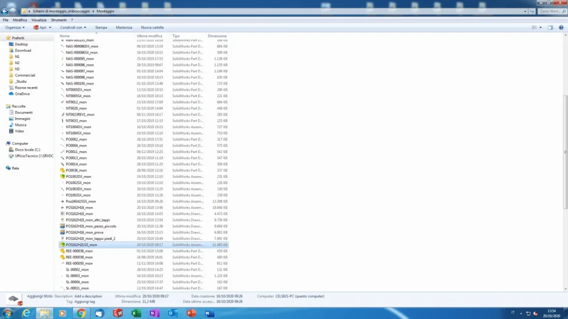

original c\user\...\desktop\h18
copy c\user\...\desktop\schemi_montaggio_imbroccaggio\montaggio
to a screenshot of the file from which you delete the particular and clearly indicate it on the image that I do not want to read a list of over 100 files with dozens of sub-assiems and imagine what you deleted.

repeat the procedure of post #39 and indicate in the list of references the file you deleted.

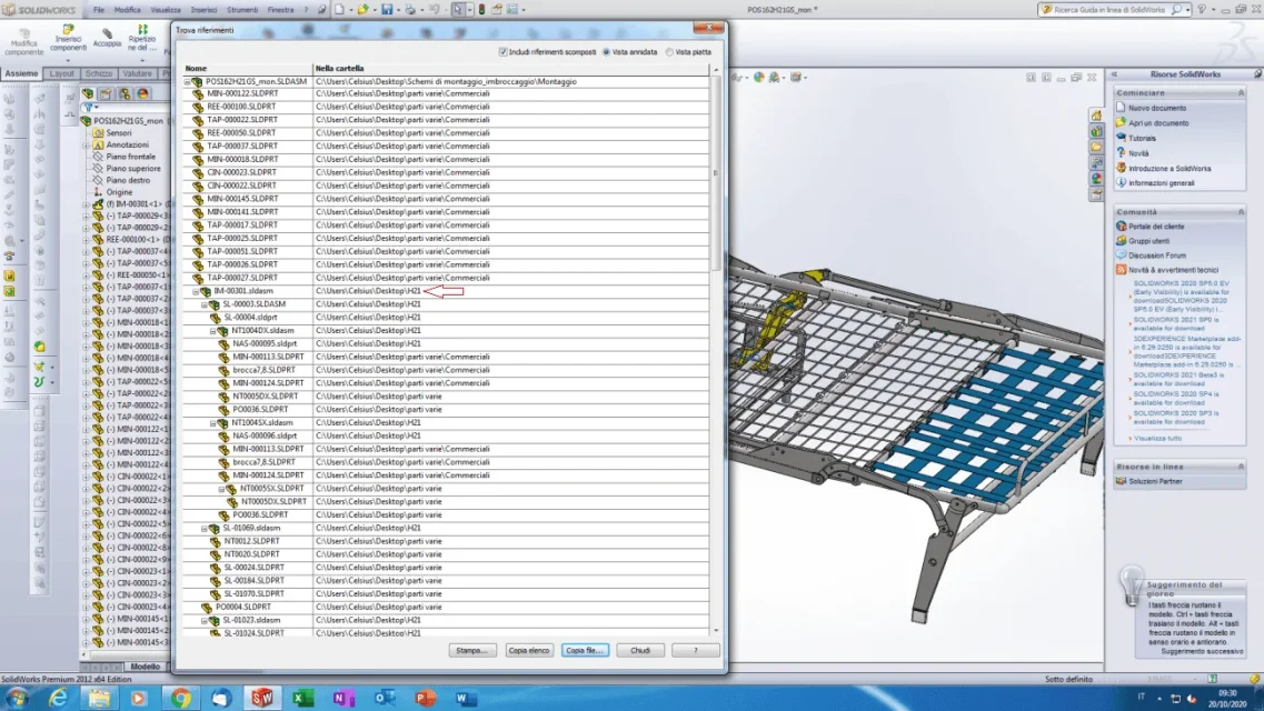

the part po004 is contained in the subaxieme im-00301 that as seen in the first image of the post #31 is contained in the h21 folder and not in the assembly folder so you are deleting a part from the original axieme and not from the copyIf I wrote something together with the pictures, you'd help

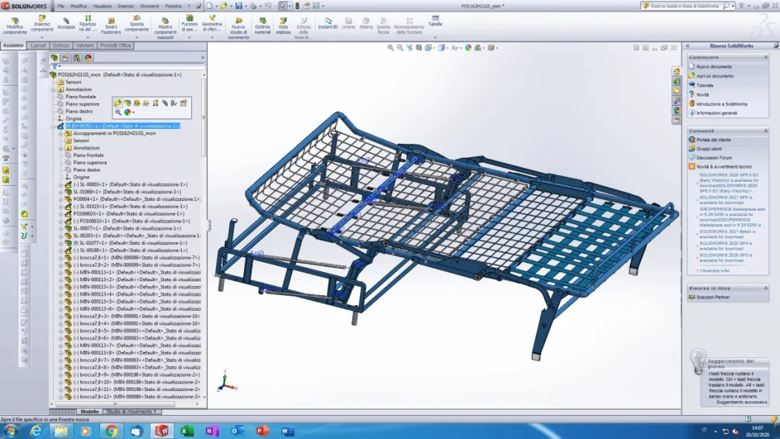

before opening im-00301 which is subassieme, I had opened the copy file pos162h21gs_mon which is copy of the axieme pos162h21gs to which I gave suffix _mon
but if that axieme has as the h21 folder address, as indicated by the reference list, you are opening the original file and not the copy that should find beautiful editing folder.

other advice... open the reference axieme so that sw loads all the files it needs and then with explore resources select all files within the folder and delete them. that open sw will not eliminate them, but in fact will eliminate only those that no longer serve
