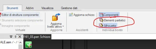

If you want to insert sketch constraints related to other apthetics present in the axieme, other than the one on which you are currently operating, you must activate the " paritetic elements" function when you are in the sketchy environment.
