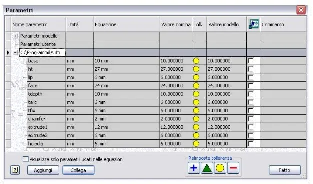

Good morning I wanted to know if someone had had the opportunity to use the table attached to the parameters. I understand better, in the table there are functions like tolerances, which I do not understand what they are also changing, there are no changes. For example, flag the key column, which the tutorial talks about important parameter, does not change anything.

I thank you but it doesn't help me, I need to understand why to give quotas in property quota changing math when I can give tolerances with normal quota? for what purpose?
Surely xthat with the command recovers quotas, on table 2d, the tolerances are loaded automatically ( you had put them in 3d) ; this is convenient when I then make the tables to others.
regarding the 3d command analyzes interference, I do not remember whether or not it affects the result
