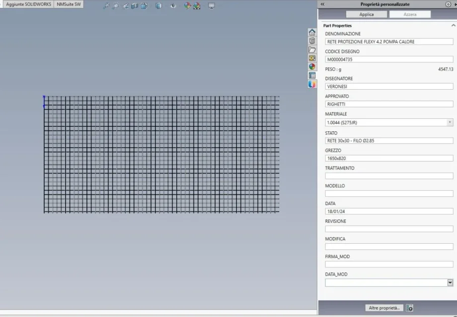

If I'm learning solidworks, I ask:
can you edit the parameters present in the part through the property tab builder also in the design environment with the property tab builder ?
see image below in environment sldprt
I have an experience of twenty years in creo and the parameters in the cartiglio I edit them also from the drawing environment. in solidworks how do you do it? can you do the same thing?

the parameters I have inserted them in the prt part of the model but I ask if you can edit even in the design environment without necessarily going into the model environment.

I mean these parameters

In my previous answer I meant those parameters. can be changed directly from the table by acting on Cartridge.
If you need to change the parameters of a part or subaxieme from the board, just double-click the field of separate materials that must be changed and the request of the cad awards "maintain links".
are not editable with tab builder, but with the above procedure.

these parameters are different from those I refer to

if the value of the property is changed in the cartiglio. make a try and let youtube lose. I don't use these systems, because I work with pdm, but I did a confirmation test before I answer you and I confirm that the property in the model has been modified. (ownership in solidworks = parameter in creo).
