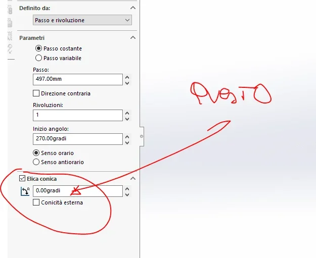

is it possible in solid will depend the parameters of a propeller as step and inclination, from quotas of a sketch? ? ?
I can't do it.
as you see from image, I have a corner share in a sketch, I need the inclination of the propeller to update them to vary of that quota

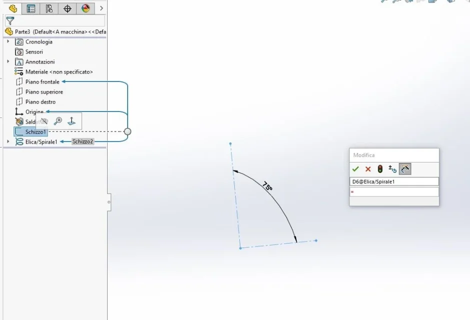

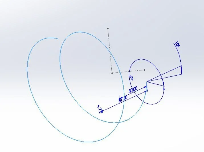

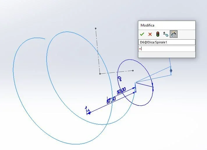

here is the sequence
1 display the size of the propeller
2 the angle
3 I visualize the sketch containing the angle to refer
4 select the quota and confirm
5 the angle and relation (you see the red symbol)
thanks massive....so on the helical bio dream work on the sketch and not on the property manager
