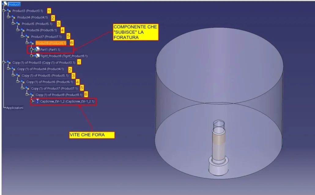

il method matrix, va bene, ma massimo you can do 3 levels of catproduct chained together , after which you can't even do certain drilling operations
but do you mean he can't perform the holes, or he runs them but gives you problems during the update? (like if I change the screw from m12 with one from m16?).
Thanks again:)
I did some tests and indeed, if I use the command "distributed drilling components" I can't run the command, but if I use the command "outside component" (see photo) I can drill quietly :rolleyes:

to use distributed drilling components you must select the catproduct n°6 and non the screw
when selecting the catproduct n°6 proposes the drillhole that is in the screw and all other possible drillholes that reside in all the catparts that are in the catproduct n°6.
However generally.. better not to exceed 3 levels of concatenation.
ps: why insert "component" e non "Catproduct"?1645201623429.png
ps: why insert "component" e non "Catproduct"?View attachment 64721
Aaaaaah ok, now I understand, thank you:)
