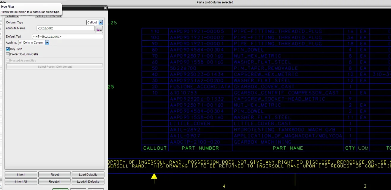

I have a problem with a part list in my drawing together.
I operated in the following way, I uploaded all the parts in session then I selected the bom and right button, edit levels and I selected all the parts that interest me.
appears all correctly except that the callout 10/20/30 (see figure) does not follow the whole table but only one part and some cells remain empty.
I tried to insert under default text $~c but too much grace, the callout is complete but all components split up even if they have the same part number.(see figure)
what I would like to get is a table with the callout starting from 10 to climb and if it were possible to exclude 2 items to which instead of the number I would like to put a hyphen
use the release 8 of ug
thanks to all

when you go to edit the callout column changes from callout to general and then resign callout so without doing anything else, it should get settled alone.
let us know.
I also managed, if I should say not at the first shot, I repeated the instructions you gave me several times but at the end I see the table as I wanted. Thank you very much
