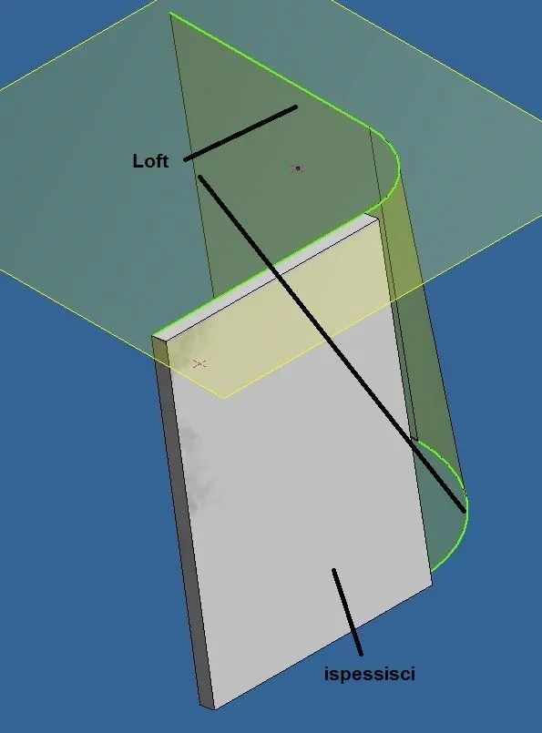

Let's say that basic activity sucks. for your problem there are various solutions, but they are not quick to describe (or at least I don't know how to do it well and quickly). try to search in the sunset forum, similar things have already been treated. However, for example, I would go to the reverse and do a part where I create a driving surface via loft and then with the thickening command I would turn into sheet metal.
I have done with the command you thicken, but the problem is not in this specific case, it is only an example. in its time when I had autodesk assistance, I placed the problem and advised me to copy in the part the objects of the assemblies as a group of surfaces and go to build the object based on those geometries that should be adaptive.....they should, but often they are not!
