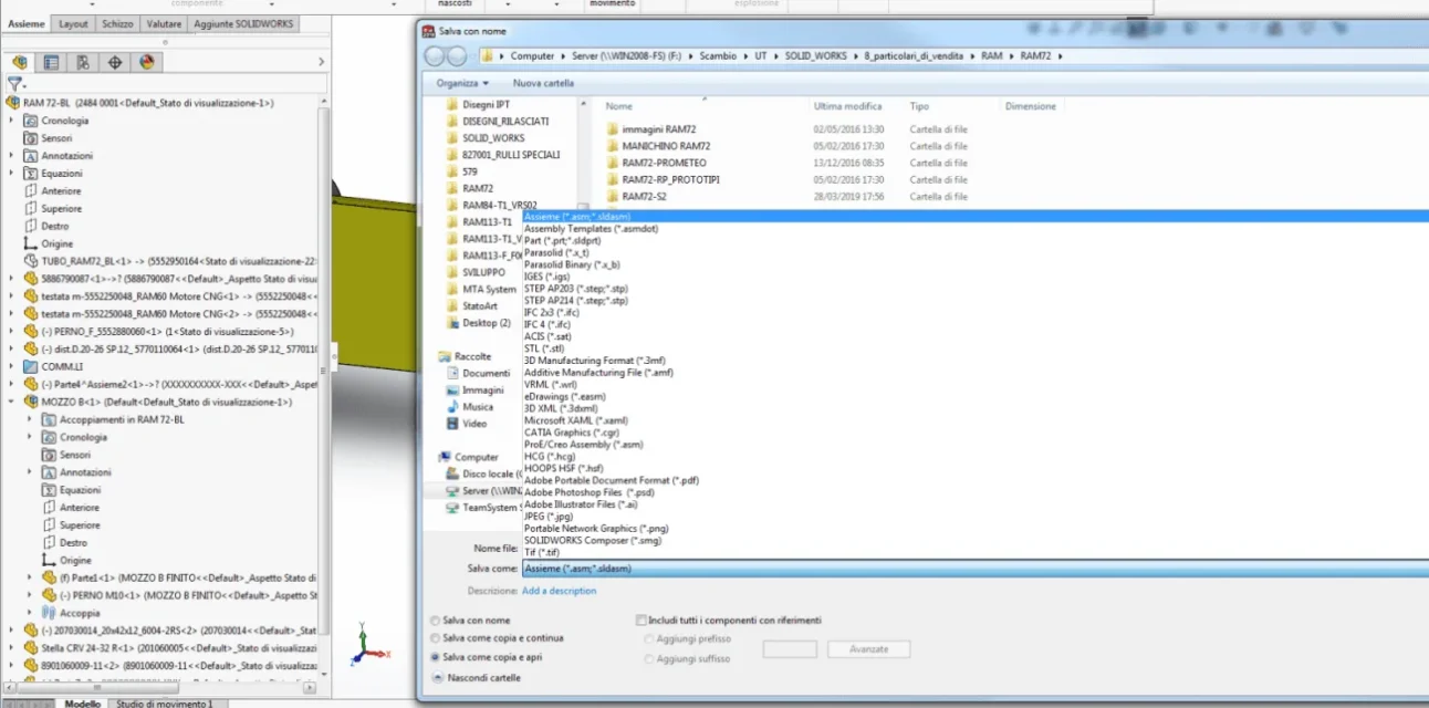

how to activate the export pdf 3d ? use sw 2018. :

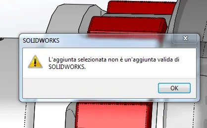

teseo, I think you zipped only the image of the button because inside there is only a .bmp fileTry to look at this macro I made it with the help of jennary
has not the extension pdf3d.. Do you need the installation cd?salva con nome>pdf>salva come 3d pdf

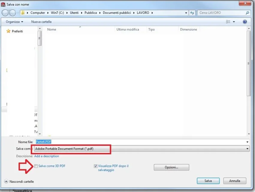

I do not have the option pdf3d.. Do I need to install the sw?salva con nome>pdf>salva come 3d pdf

non c'èI wrote selecting the pdf extension. in the image you see that you only opened the curtain with the list of extensions and you have not selected anything
but why don't you select that damn extension pdf?Can you explain where? ? . . .
I'll tell ifnon c'è
graziiiieeeeeeeeeeeeee!! risoltobut why don't you select that damn extension pdf?
I think I do.
with the image above I realized... I'm not perfect. :graziiiieeeeeeeeeeeeee!! risolto
now the daughter of the problem is born: I close the app.... :but why don't you select that damn extension pdf?
I think I do.
