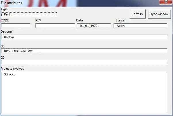

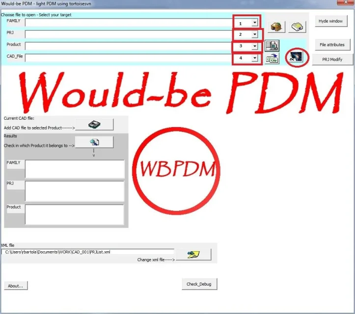

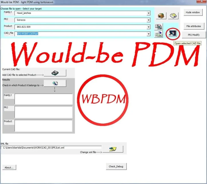

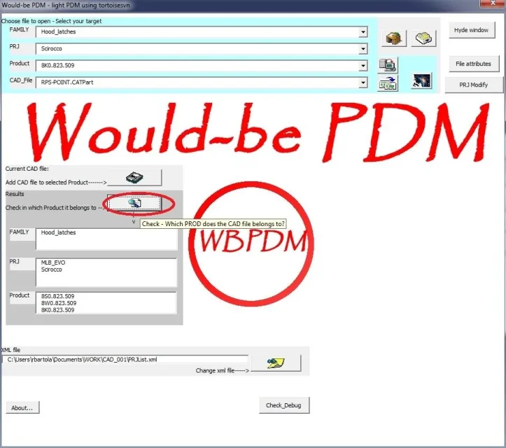

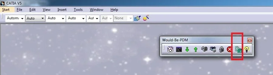

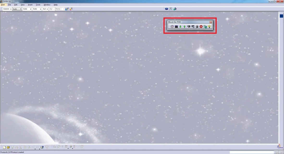

I was looking for an economic tool to manage cad cad files.
I saw that with svn technology (https://it.wikipedia.org/wiki/subversion) you can do something functional.
I searched for packages already made but I didn't find them so I wrote something.
It is an interface (macro and sw visualbasic in catia) with which "rule" svn.
to be able to use my "quasi pdm" (wouldbepdm) it is necessary to install doveisesvn (http://tortoisesvn.net/) and know how to "handle" a little with the macro-cake.
as soon as the product will be a bit more mature I will write a few lines of manual.
in the meantime, who has a hurry to test it can freely download it to: https://github.com/robertobartola/wouldbepdm .
I hope you're at least a little helpful.
