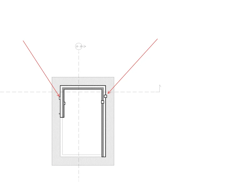

rvt 2014 - prova modello strutturale.webp: how is it possible that the same pillar (structural) inserted in the same type of wall (of superimposed type) behaves differently? press allego see clearly the right and left pillars
structural material of the pillars? are they joined both the dx and the left ones to the wall? version of rvt?
I tried again this morning....because it seems impossible: the pillar is structural with cls thrown into operation by bookshelf, the fact is that the pillars are all inserted at the same time (with the same command) and to right remain visible (as from structural?) and to left join the wall. What is a wall problem? In theory they are equal. rvt lt 2014 with update1

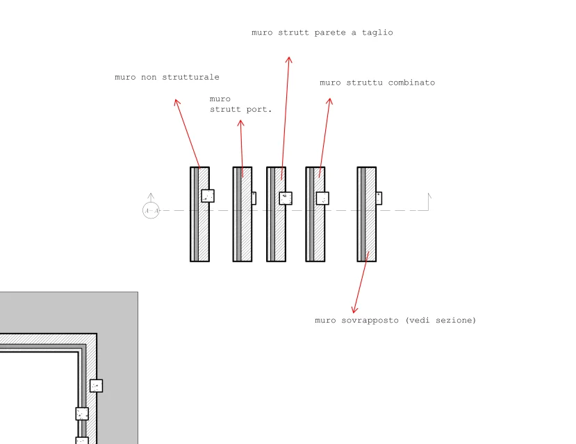

see pictures: how do I decide which function has the overlapped wall (last right, see also section)rvt 2014 - connessione muro pilastro.webprvt 2014 - connessione muro pilastro - sezione.webp
Perfect!! Thank you. solve.
