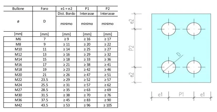

I would like to create a dynamic block for a steel plate with holes, this must maintain some standards (as seen in the image
) I would like to choose the number of holes in the plate that will be arranged according to the p1-p2 raster as it was a series, determining for each type of hole the minimum distances. Is it possible to realize a block that asks me the type of hole the number of rows and columns from rows?
I managed to connect through the dynamic table the first 3 columns (type of bolt, hole diameter and distances from the edges) now I should switch to rows and columns but I don't know how to do
I hope to be explained thank you very much for patience and help
