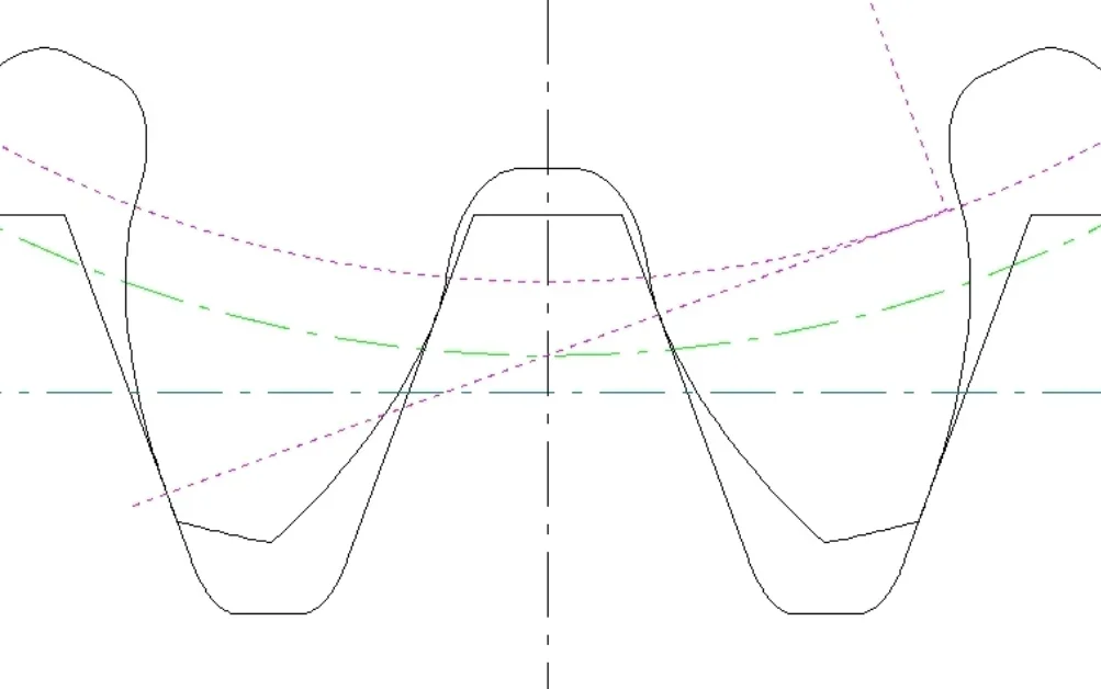

according to the literature to verify a lazy system and rack can be transformed into two gears where the rack becomes a wheel with at least 300 teeth.
you should know that a gear with 14 teeth under cut:View attachment 71264then we find the base of the tooth narrower and therefore weaker. the alternatives are: number of teeth greater...17...18.... or see with shift of positive profile at least with x=0,2.
I chose m=4, z=14, x=+0,2, b=40 because I am accustomed to making profile shifts and I build gears from a specialized company, in this way increase by about 30% the tooth capacity.
View attachment 71263pinion and rack have a bending safety factor on 5000 hours of more than 8 for the pinion and more than 14 for the rack but wear on the pinion is very accentuated and for this it is recommended the surface tempering of 54/56hrc.
also with the free online computer khk gear you get rough the same results with the jis rules.
Obviously dirt, humidity and bad lubrication significantly shorten life.
you can possibly simplify the account using lewiss and make the calculation to wear according to the hardness.
