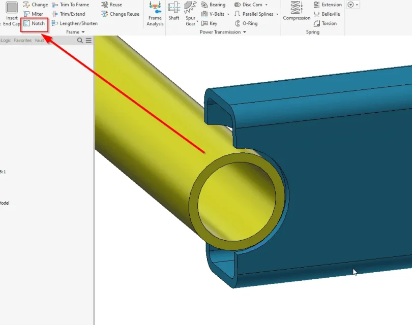

Good morning, I am a beginner of inventor and I came across a little trouble and I hope to find help here...... in the chassis generator it is normal that the cutout function does not work between a square section tubular and one round section??? Do I have to do everything manually? ?
crops\estendi requires a flat surface as reference. . .
if you want a result as in the screenshot you have to try "notch"
Thank you so much! is the only one I didn't try??? ? In the meantime, I took off with a sketch and an extrusion? ? ?
