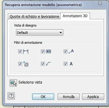

Do you think you can put tags in 3d visualization? we say how the field known but where the text is read.
Yes, in the annotated multifunction bar. you can add quotas, texts and other information. you lose them if you save in step, but if they serve you as a reminder it can be useful.
you have to select a view of the table 2d, then dx button, recovers pattern annotations_foto__117.webp
