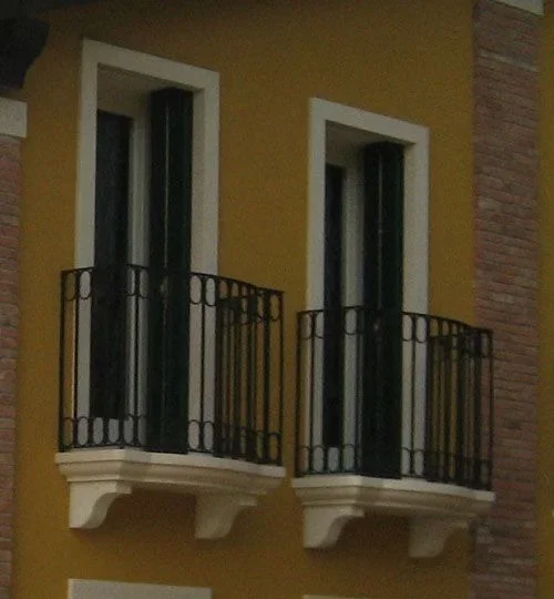

I just started working with revit 2014.
I have to do these attachments, how do I do?
Can you create a family? if you give birth to? Can you give me a trace?
Do I need to model her in place, with a shovel and railing?
explain yourself from scratch how to make a poggiolo like that would take a half day of training, especially if you are not familiar with the editor families...you can create a balustrade? and a loft board profile? How do you connect with revit 3d modeling tools?
I cable quite well with families and also with modeling, I managed to make a family with window with marble contour, balcony to the vicentina, openable.
I wanted to know if to make that poggiolo, I have to model an architectural floor and apply a border with profile as in figure, for the railing, now I study and learn to make them, and the two ways below, I do them with extrusion local model, so I will have 4 separate elements ( 2 modiglioni, 1 insole and 1 railing), to copy in every window.
Is there any other method?
the way to have separate objects for me is correct, even if a priori seems strange then the advantages you find them all in the case of computations and modifications.
for the two ways I would leave the local modeling that is never a big deal and I would turn on a family based on surface or wall. On the contrary, I would say that this is precisely the case where the implace should be avoided as the plague because, of those ways, you will have a lot to place.
to facilitate copying and inserting you can create a group with the elements that make up the poggiolo.
