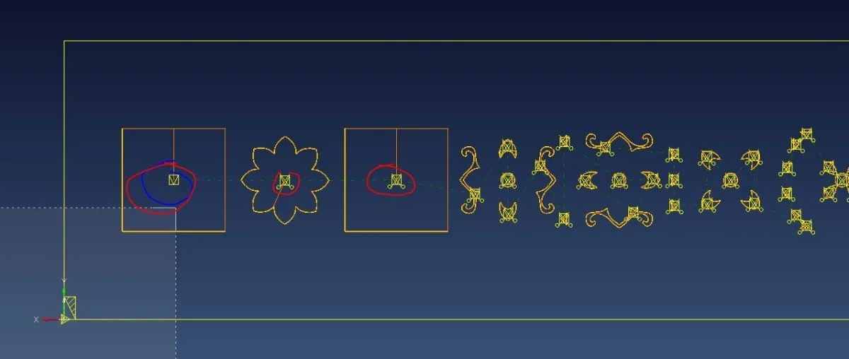

Try to publish some screen shots. Maybe they use different terms, but always there you have to get there.
hello and good year pep.
thanks to the screenshot, but I think it also needs pages of the technological parameters that you insert when you create the processing.
I repeat: I don't have the wire, but I expect to find us one or more parameters related to the infiling points.
Perhaps, however, keeping "in view" your request for help, some more informed users will help you better than me.
