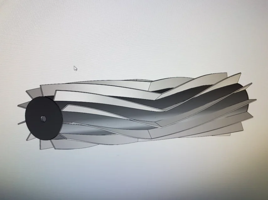

hi to everyone, I ask your help because I should send to a supplier the directions to cut and fold a component, only that I do not know where to put hands. I explain better, the piece is a component of a constipation roller, and it was created by making a loft and chased to make it shape perfectly to the tube, I used the intersection function (I know that I should have used the flexor function, but for the moment I can not use it). Now I don't know how to do to flatten it and find the fold lines. Can anyone help me? 20190208_142854.webp
I don't think s.w. recognizes blades as sheet metal parts. also there are no folds, but curved.
However, it is better to attach the file.
is right xxfast, it is not a particular to do with the sheet module because it has no folds, but it is done through a twist.
even in reality you do not do it with a bending machine

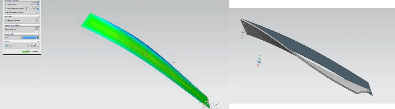

the 'development' of such a thing provides a deformation and therefore of the commands that are not of sheet metal. This is done with nx, I don't know if sw has commands like this.
in the attached image see how much and where the piece is deformed and how the 'development' appears.
