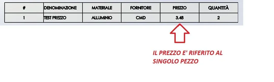

Good morning, guys.
I should introduce the price of each particular (normalized and produced) but with the distinct I cannot manage it. I'll explain. I correctly put the price of the single component and good software, it is correctly indicated in distinct but if the quantities of the above particular are double (e.g.) the price remains single.
allego screeenshot esplicativo.
Does anyone have any suggestions?

I have no way to see the file, but if the price is a file property you have to do this process:
add a column in the set where you call the price
in the column where the total appears I insert an equation in which you multiply the amount for the single price.
separate the column you added and hide

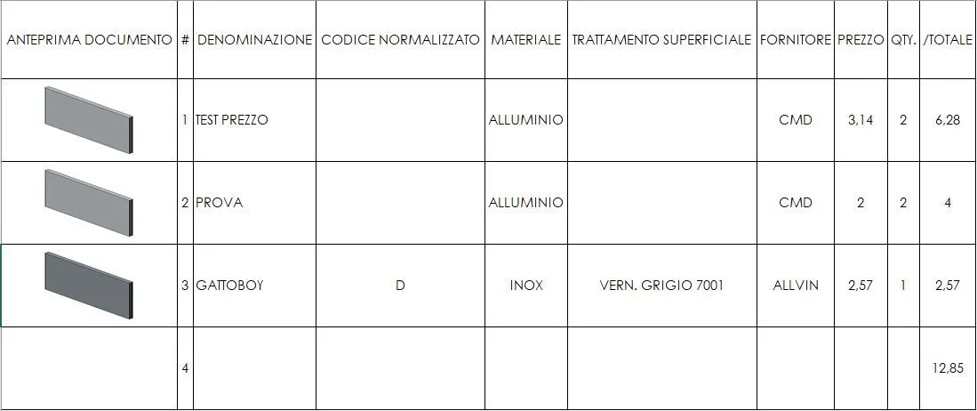

Thanks massive, always on the piece!
