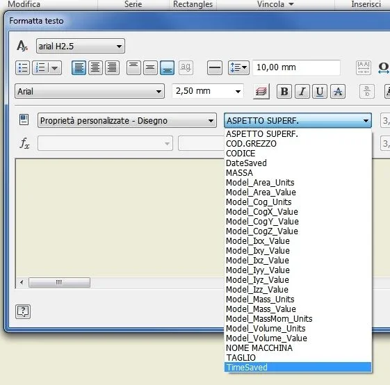

you can print in a table (idw file)
all data of the "physical" subfolder of the properties of a piece designed?
Yes, you must define a stamp or a sketch symbol or a normal text, and recover the iproperties that interest you
