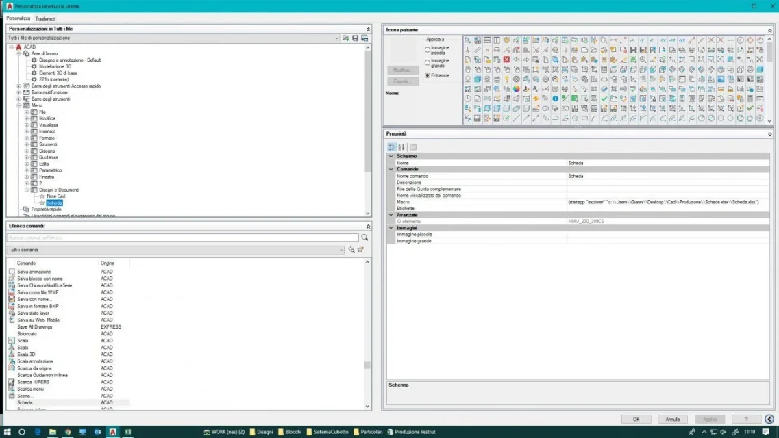

Good morning to all
I have inserted a new menu in autocad, in "personality user interface", which contains various commands that recall routine lsp. between these commands I would like to add one ("scheda") without creating the lisp, but writing the code directly to the macro voice, how do I do? the code lsp is as follows:

with only the instruction does not work, on the command line the code stops at:(startapp "explorer" "c:
adding (c:scheda), I open the document folder
to describe the route of the file you must use "/" al post di "\" because this symbol causes a macro to stop to request user input.
Code:
(startapp "explorer" "c:/users/gianni/desktop/cad/production/schede xlsx/scheda.xlsx")
I used the following instruction, but only the excel program opens with the warning that the indicated file does not find it:
(startapp "c:/program files/microsoft office/office16/excel.exe" "c:/users/gianni/desktop/cad/production/schede xlsx/scheda.xlsx")
the problem is that you have a space in the folder name "sweden xlsx", try with:
(startapp "c:/program files/microsoft office/office16/excel.exe" "\"c:/users/gianni/desktop/cad/production/schede xlsx/scheda.xlsx\"")
