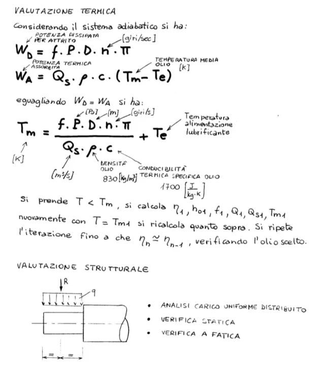

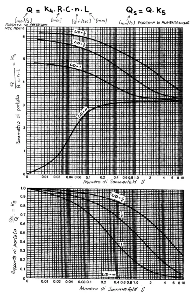

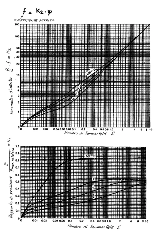

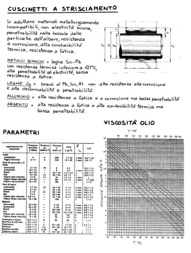

Screenshot_20230415_172726.jpgScreenshot_20230415_172742.jpgScreenshot_20230415_172759.jpgScreenshot_20230415_172815.jpgScreenshot_20230415_172815.jpgScreenshot_20230415_172834.jpgScreenshot_20230415_172853.webp

18 years have passed ... I went to look and on shigley's mechanical engineering design there is all treatment complete with these graphs, heat calculation, flow rate etc.
