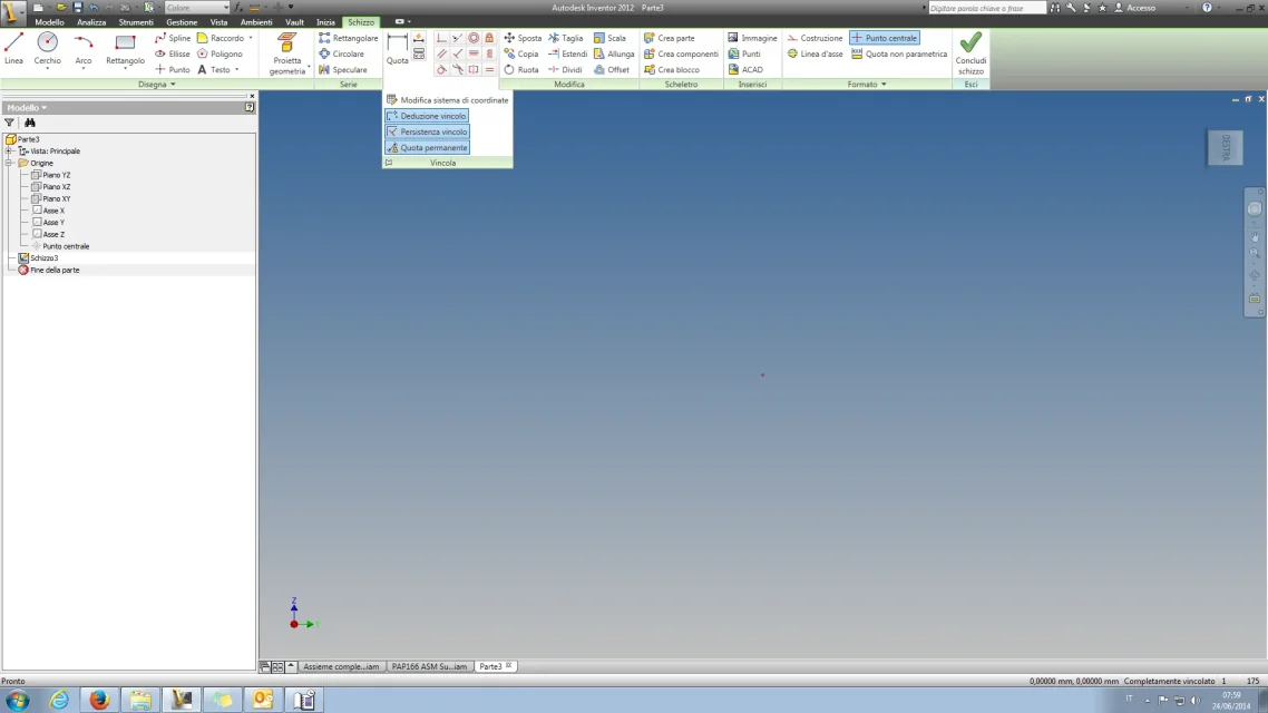

I have a little problem with the sketching environment: each drawn line is free of coincidence constraints even if the command starts from the projection of geometry, for example the center of the axes.
Does anyone know if it depends on a particular option that you have disabled?
Gabriele
in sketch environment there should be two settings to activate "deduction bond" and "persistency bond".
Thank you, I never noticed those commands.
I have just tried, unfortunately but their activation/disactivation does not solve the problem.
Who knows what it depends on...:confused:

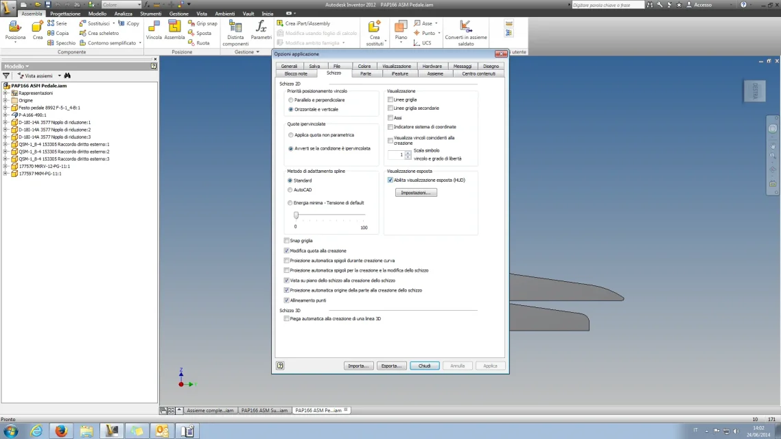

very strange, I had the same problem s clicking on "persistence constraints" went in place.
maybe even check if the settings you have are like these that I'll attachImmagine B.webp
I found it! :finger:
But look at you...
in sketchy environment, select a line with the button dx --> select "constraint options", and I find all the boxes of unchecked constraints.
Of course, it was enough to choose the ones I'm interested in and the problem is solved.
