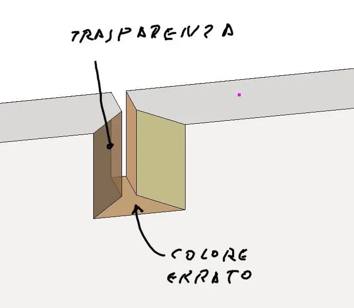

Hello, everyone.
I have the need to create place walls from solids, in which a "window" family consists only of vacuum.
the problem arises that the above vacuum instead of taking the colode of the wall assumes a proper color and makes the internal faces trsparent, as if the vacuum had a proper material of category that I can't change. I attach an image.
no problem if they are inserted into normal walls.
suggestions? (please don't tell me not to use place modeling, etc.,...)
As for the material, you must assign a material management parameter to the place wall, or select it from the properties.
to eliminate the transparency that happens by inserting a vacuum generated by a family, it is necessary to insert a vacuum generated directly in the phase of modeling the wall, which then will be aligned to the edges of the vacuum generated by the family.
in your case, being your family inserted into the place wall, a family of voids, the passing hole can be generated directly with a vacuum generated in-place design of the wall
Thanks for the answer.
I tried by inserting a material parameter, but with nothing changes.
the only system I found is creating a new filter of the phases of work and asegnating a replacement material, in this way the visualization is correct and also solves the problem of transparency.
