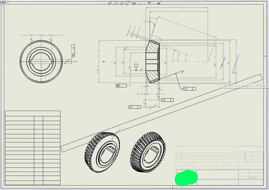

I add this image:
I have to close and reopen the program. I know it's easier for me if I have an open acrobat reader.
Can it depend on the same cause?

sure is a problem of ram and not graphics card?
the benchmark (passmark) seems good to me. in known diagnostics that the driver used is not certified. but let's say that it doesn't exist for this video card.
Can I try installing an older one?
I add this image:
it is a problem of graphics card. what operating system are you using? Do you have windows 10? If so, what version of 10 do you have?
win10 pro, versione 20h2
So you're okay with os, in the past with old versions of win10 I've had problems... at this point, to solve the problem) you need to test drivers until you find one that works (without any support because not certified) and if you don't find it you need to change the card.
