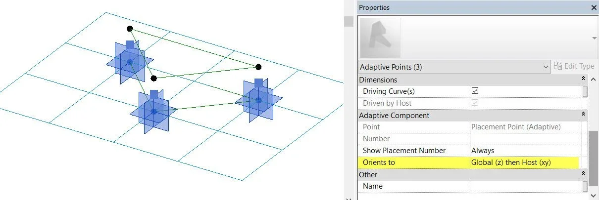

You should construct the triangle with points of reference that are ospected in the adaptable points, and lines of reporting that connect those points of reference. After, you change the property called "orients to", to the option "global (z) then host (xy)".
