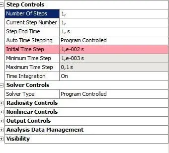

I am carrying out a thermodynamic simulation on a lithium ion battery for autotraction on ansys workbench.
are in transient thermal environment.
I've set all the screens and I have to decide how many steps to do and how long to make them. Given previous results I have 200 step bison from one second each.
After trying a simulation with 40 steps from 5 seconds, I now want to set 200 steps from one second each.
result, it gives me error the item "initial time step". I tried to remove the car time stopping but this way the simulation never ends. What can I do?
mention the fact that before setting steps from 5 seconds I had safely simulated 100 steps from one second each.
ps: annexed the problem

steps o substeps?
immagino tu sia interessato ai substep.
in questo caso:
number of steps: 1
current step: 1
step end time: 200s
initial time step: 1s
minimum time step: 0.01s
maximum time step: 1s
output controls: every time step

you're telling me that the rumors:
do they refer to substeps?
I introduced myself to the topic, I thought it was enough.
