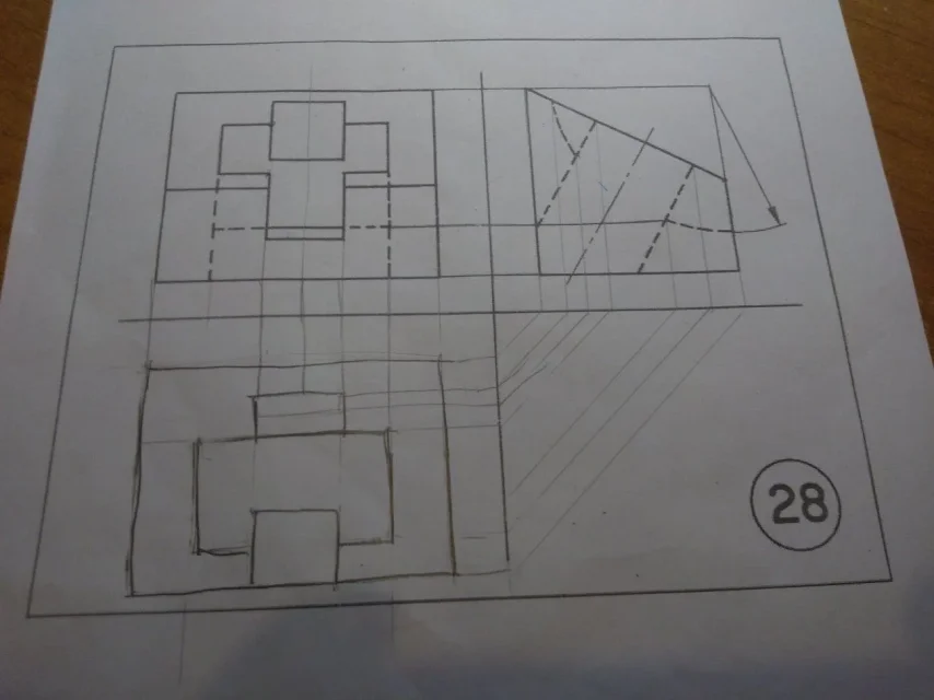

I am completely blocked on the annexed exercise where you have to get the view from above and an assonometric view.
Can someone please help me?
Thank you so much!
on the method there are!
on this exercise just no. in fact how much I have realized does not come back absolutely
I would like to avoid solid edge for not having "helps", but to understand as far as possible independently where errors are.
I wouldn't see it as an aid, like an analysis method.

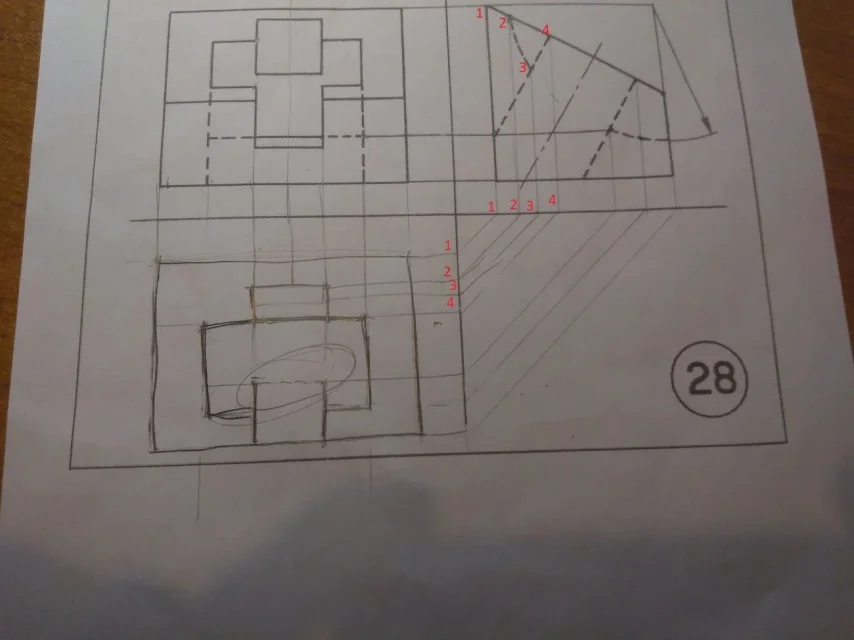

Concerning what I did I saw a possible error that I corrected as you see below
Then I just can't figure out where I'm wrong.
solid edge is still not perfectly in my strings.
you are wrong because you consider the 4 projected edge (from the left) as a continuous line, but it is crossed by the circular excavation.
draw them separately: before the circular excavation and after the rectangular excavation
4th edge, so the error is on that line?
