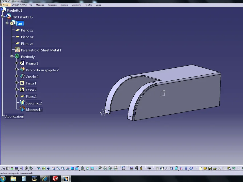

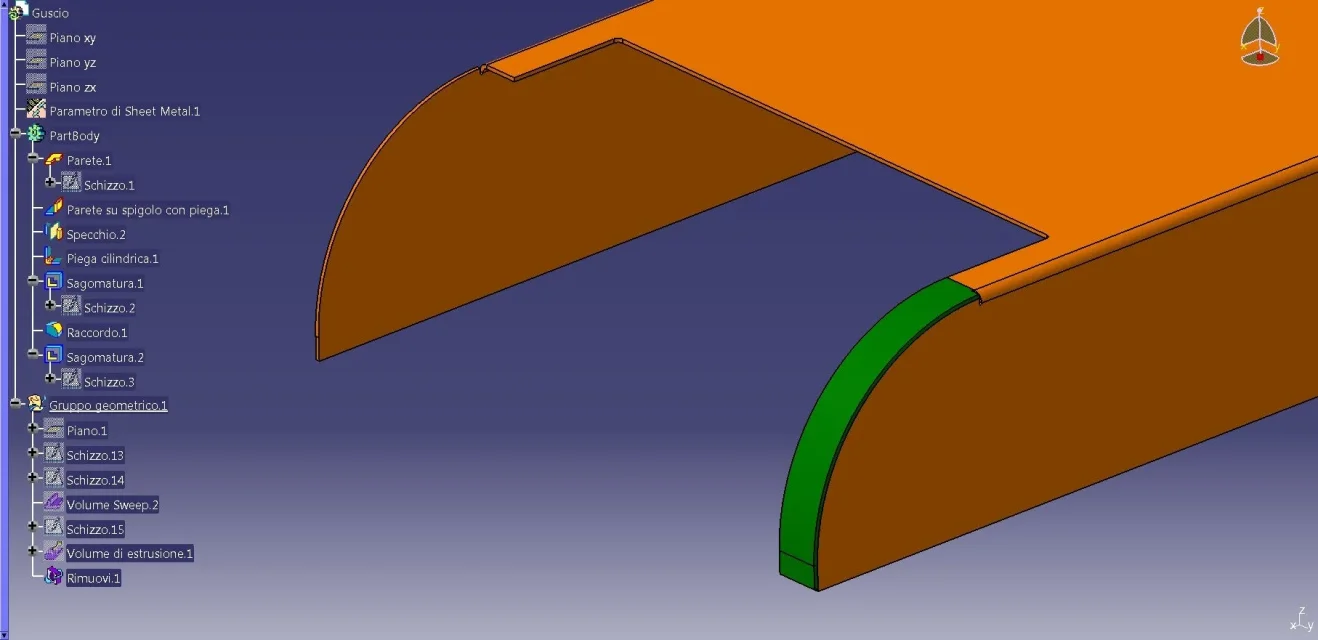

I have a problem with sheet metal. when using this sheet form (and knowing it little) I came across a
bending I can't do. in the two photos I attach you can see that to solve I have done it with the surfaces but unfortunately
do not follow the development plan to create drawing.
what I have to create in sheet metal is the folded green sheet.

the green and orange part are part of a unique piece?
the green part is a single piece with the orange part.
this shell I have to create everything with processing only bending.
I hope I've been clear.
thanks for the answer
then we summarize:
a flange that runs along the two edges (the circular one and the straight one) does not create it.
Did you try with an extrusion and then ray?
I better explain: extrude the profile of the part in green and then apply a radius between the "new green" and the orange one.
if you continue to have problems and there are no issues of secrecy try to post the file.
Bye!

thanks for the answer but my problem is not to create this cover in fact you can do it with solid part or with surfaces.
the problem as I told you is to tie the development in plan with drawing, and this can only get you creating it completely with
shett metal otherwise I must also create the development in plan cutting the connection with model 3d and its modifications.
