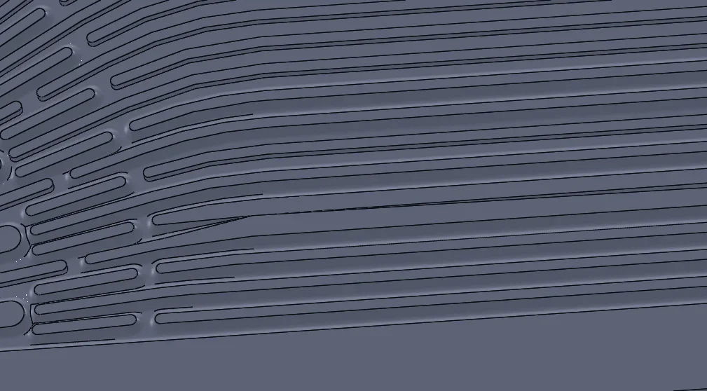

searching on the net I found that the method of selection has "problems", the image must be sufficiently zoomed and understand all the elements to be connected, which I did.
I tried to use the function Featurefillet3 inside and outside the for cycle, in the first case the macro creates only the first 6, while in the second it combines some elements.

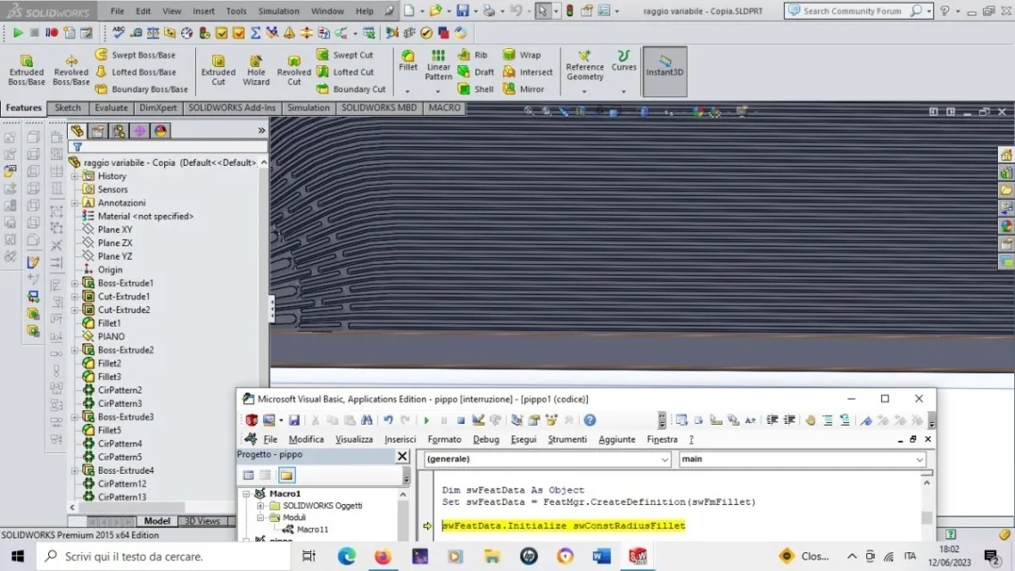

di seguito il programma in vba, sto usando solidworks 2015.

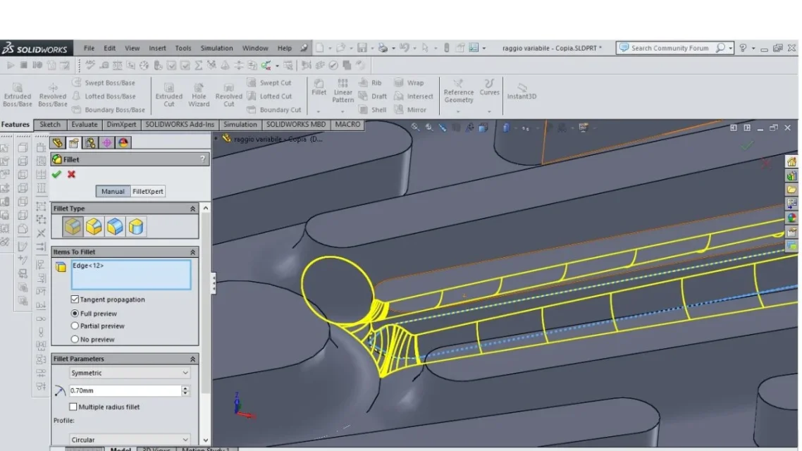

raggio variabile - 2.webpAs you can see, element 7 is not connected and the two precedents, joined together.
nothing changes if the graphics area is covered.
you should also turn the model along with the macro to test
the maximum radius applicable for those edges is 0.7 mm, with 1 mm does not turn the radius from the third edge onwards.

very probable, as they have already written above, that the problem is the radius too wide that intersects excessively with the adjacent ones (by curiosity, try to reduce it up to a value that is accepted).
that function collects all the edges found between the vertical extrusions and the bottom; If you don't need someone, you can uncheck them individually by clicking on the "ghost line" of that edge.
but I repeat, you cannot force the system with incompatible rays. not in the same function, at least
