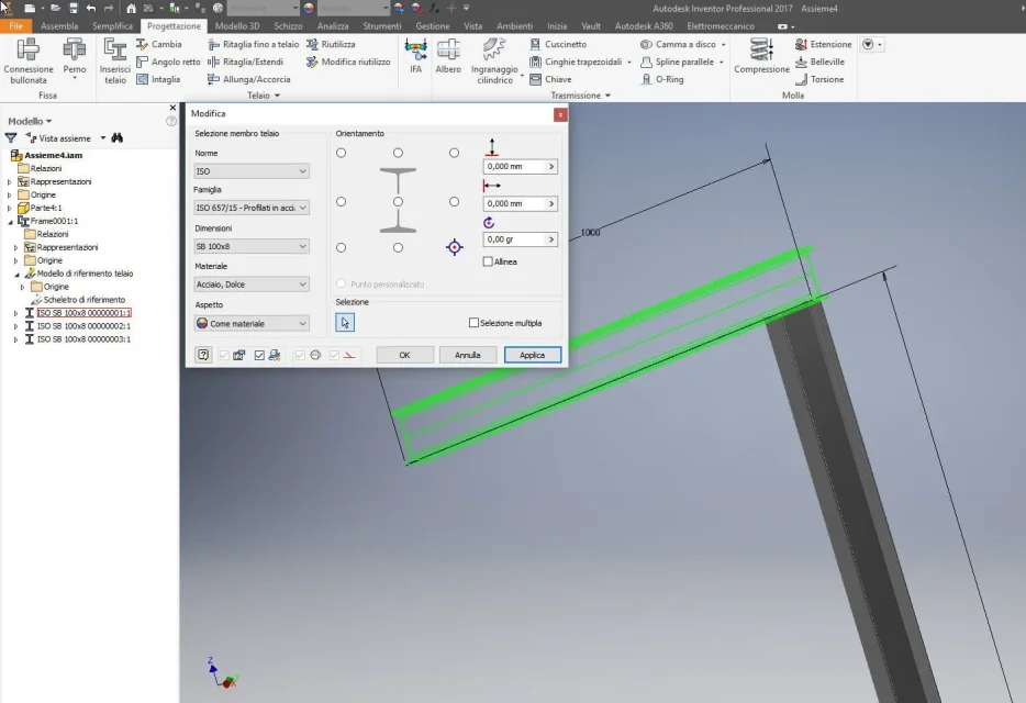

Hello everyone,
I find myself struggling with the following problem:
I have to model a frame with profiles ipe 300 uni 5398 and heb 300 uni 5397 but in the inventor library I do not find the above profiles.
can you find somehow to download or anything?
Thank you all in advance for the answers given.
thanks to the Matteo response,
only one thing, the customer then this profile in his library logically will not have it, and this I imagine is a nice problem.. .
by making a pack&go of the whole project, will also be copied the 3d models obtained (parti 3d.ipt), so he will open your work, if instead he will want to make changes, will not have the library and therefore you need to expose it and that he then amounts it
(although at this moment I don't remember how to do) try to give an eye and make some evidence
I think the first option is enough, otherwise I will ask that I provide the library if anything they have one.
thank you many matteo for the help, you were very helpful!
