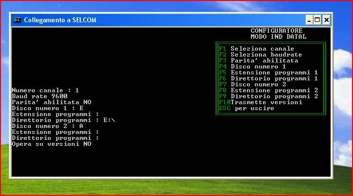

ciao @danalvez as I promised you I'll attach you image of my configuration
see if you can help
