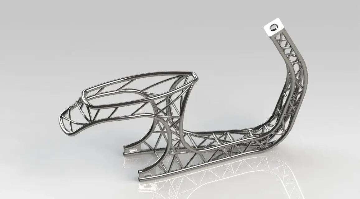

I submit the work I'm doing, even if it's not complete
the idea starts from the restoration of a vespino 50 special that eventually became a total redesign of the medium
use rhino 4 and for rendering and analysis of torsion efforts and bending solidworks
my doubt arises from the fact that these analyses I made them considering the frame as a unique piece and not as welded parts, does something change? (I suppose so) where can I read something to understand how to do it?
the shell will be in thermoextruded polycarbonate and obviously not carrying
thanks to all

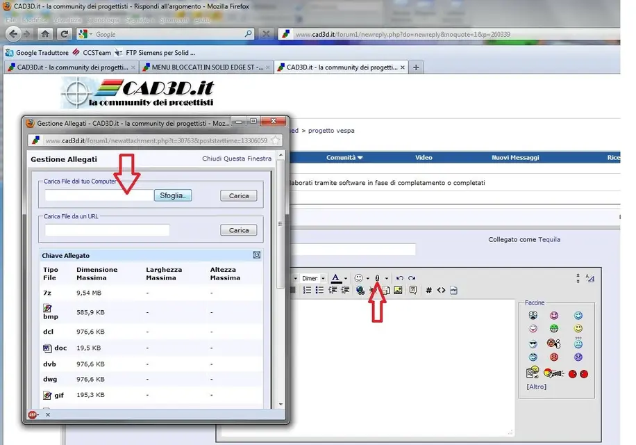

Hello and welcome... If you need to attach the images use the "graffetta" command that you find while writing a message, you are looking for it from your pc and then upload it to the cad3d server so you can't lose over time if external links are removed.
I attach explanatory image. Hi.

Hello, geko!
I do something with sw and fem, if you need a hand, don't mind writing!
I honestly for now carry out studies on welded carpenters and save them as assemblies:
I obviously change everything to dots to perform studies, with cuts and facial couplings so that I always have a contact between the surfaces.
you have pm (if you cannot read them I ask you here, but are you also on vol and vr?)
