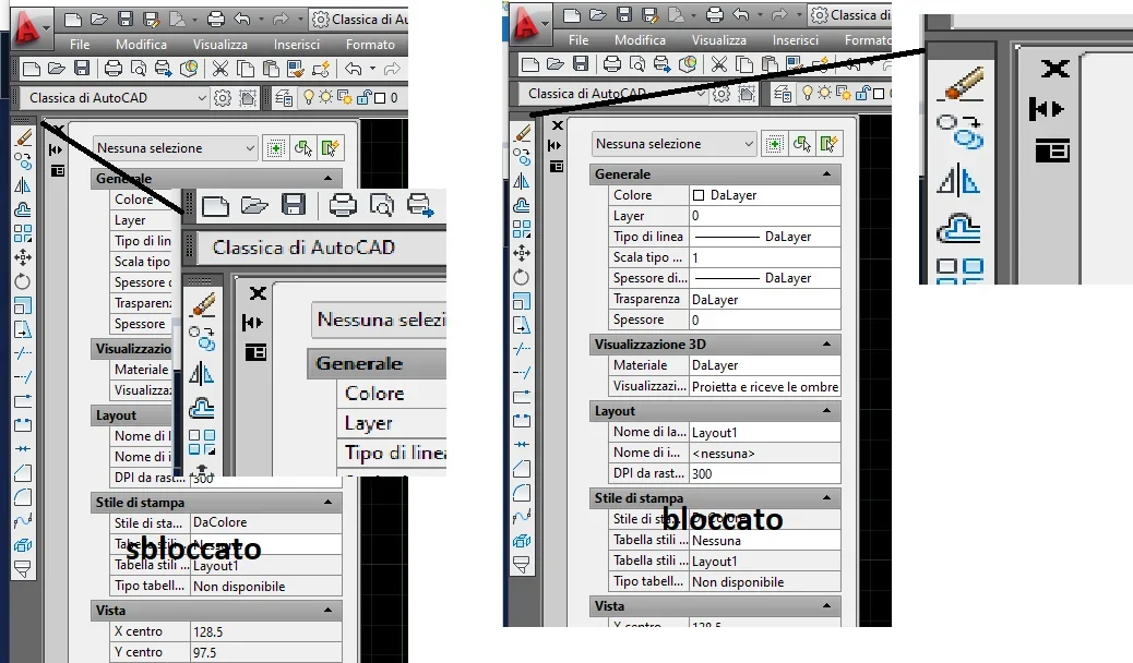

Hello everyone,
I can no longer change the width of the property layers and that of the properties.
Usually you went on the outer edge and clicking I could drag it to make it wider or narrower.
over all once such palettes I had moved them on the secondary monitor now I can't move them anymore.
I don't know what happened. .
What a nerve. .
I tried to restore factory settings and now I can move them. when however restoring my old settings the palettes do not move anymore. .
You probably blocked them.
you notice why you see the smooth bar without the zigrination at the top or left end
the system command is lockui, or do it from the icons of the lower part1669744507903.webp
no va bhe sin that we are on a forum of technicians... Otherwise, four prayers were left in Veneto. .
Thanks massive.. as always at the top..
