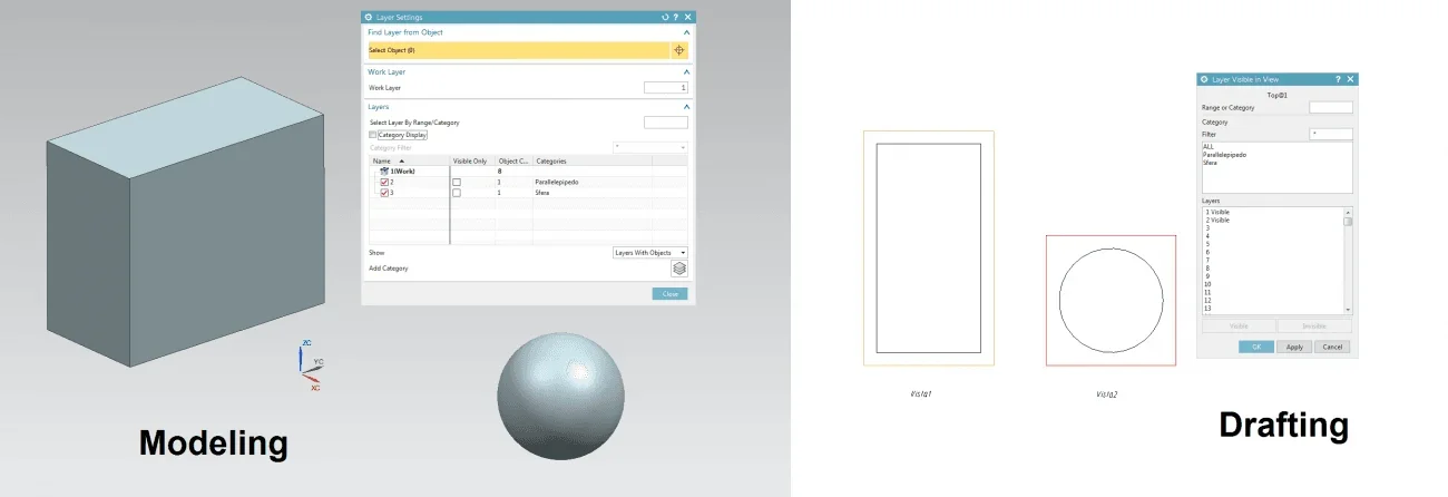

good morning, I would need to put the same component (which has 2 reference groups) in a technical sheet: 2 views with the two reference selections. Thank you.
p.s. views must always be updated

reference sets (reference groups) are used to display the geometry of a part together belowmodel.webpin drafting (which, however, if used in master model is a set) the technique is different: you have to move the geometry to different layers and then in drafting views use the comendo layer visible in view.draft.webpI hope I explained.
