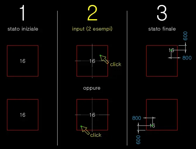

I ask help to accelerate the execution of the shift of texts from the geometric center of closed polylines (centinaia per day!):
1651734641510.pngas illustrated (I hope clearly), with a click in the point indicated by the yellow arrow (... generic point, just be it inside the dial highlighted by the dash) I would like to get the shift of the text in the position indicated in the diagrams "3 - final state".
If possible, to speed up work, the command should remain active to allow sequence shifts.
I add that the polylines I use are always on layer called "post" and the text is always on layer called "mq".
I attach a dwg to facilitate evidence.
Thank you in advance!

@rpor66Great! 1000 thanks!@sgreender: thanks also to you for the interest shown. My planes are populated by polylines closed a different one from the other. to get as quickly as possible the indication for each of the surface square meters I use a lisp that writes to me the area of all the selected polylines in the geometric center of each of them. a first problem was that these texts, occupying the geometric center were overlapping with other texts already present inside the polylines. a second problem was that some inner corners of polylines are occupied by texts that identify the various areas. with the command of rpor66 I can "draw" the text that expresses the squares towards a corner free from other texts/objects inside the various polylines. Unfortunately, using blockages, this would complicate. . .
