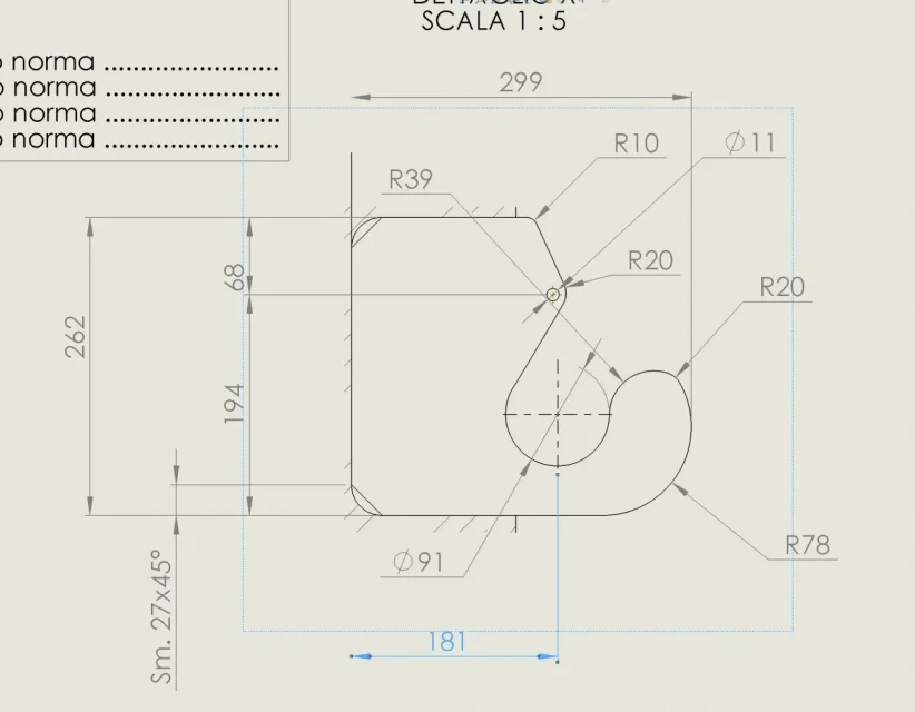

I would need to know why in 2019 sw detail, some quota extension lines are not displayed.
for example of a horizontal quota with size 181, maybe the right extension line, is visible while the left one, no (example in the attached image)Cattura.webp.
Can you tell me how to make it look, please?
usually happens when you are seen trimmed; widen the trim.

Thank you for the proposal but the view must remain as it is for example. I can't broaden them.
if I do not thank it is because the proposed solutions have not led to any change.
then it would be useful, for you, to say so to find other solutions.However thank you not for the correct solution, but because other people interested in your problem and tried to help you.
draw the missing line with a sketch or instead select the edge select a vertex.
Not even taking the edge out. I already tried with the missing line but I wanted to avoid it. I was hoping to avoid the design of the line.
Thank you and I will try so.
what sucdfede can be derived from the fact that selecting the edge does not select that of the lifting ear, but that of the adjacent body and that it fills.
to circumvent the problem you have two roads:
1 return to the environment part/axis and make visible only the body to quote
2 in drawing environment click with right on line and choose other selection to select the edge of the ear
