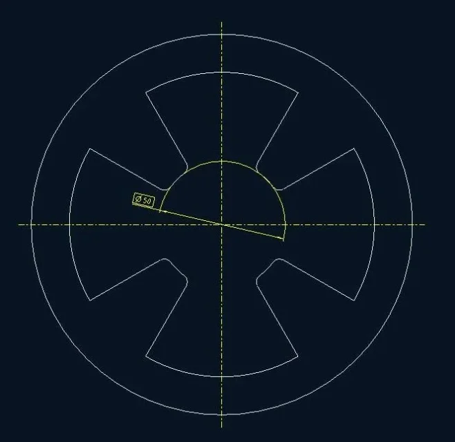

do you succeed in drawing pro/e to insert the share of a diameter as in the attached image? or with the quota that follows the profile of the reference circumference through an "auxiliary" line. I hope I explained.
Bye!
If I understand correctly, you should solve by clicking twice on the circumference arc you want to quote.
Bye!
exact, so doing instead of making the quotation as radius (rxx) is quoted as diameter.
However also using the "flip arrows" (click dx on the newly generated quota) I can not find the system to make the quota as in the image. . .
you are right, sorry but I return today from the holidays, and I am very slow :frown:....after clicking dx on the newly generated quota (as you rightly said) you must select "show as linear" (I have menus in Italian). .
I had also tried this option but it doesn't make it as in the image even on this street...

I meanwhile managed to get this, trying to reproduce something I saw.

It could be, even if looking a bit I didn't find any variable that seems to be about that graphic behavior.
But I might not have found it, did you see anything?
to the eye comes to mind default_diadim_text_orientation parallel_to_and_above_leader.
for the square around the value then you only have to edit the properties of the quota and in the window display view just click your baseBut here we are not seers! If driver doesn't make us understand better it's hard...
Yes, that yes, I was actually referring to something that would control the extension of the edge of the circumference arc (at least I did).

Yes, that's exactly what I was looking for!
to edit "default_diadim_text_orientation parallel_to_and_above_leader" instead? ?
Thank you very much, very kind!
select the quota, right button, property....
the values of the drop-down menu that I have highlighted are those that you find associated with the variable that indicated you calacc ((PHP 4 = 4.1.0)).
if you always want this type of text orientation, then enter the drawing configuration file (*.dtl), and change the voice (PHP 4 = 4.1.0) setting the value on parallel_to_and_above_leader. then remember to save the dtl file.
