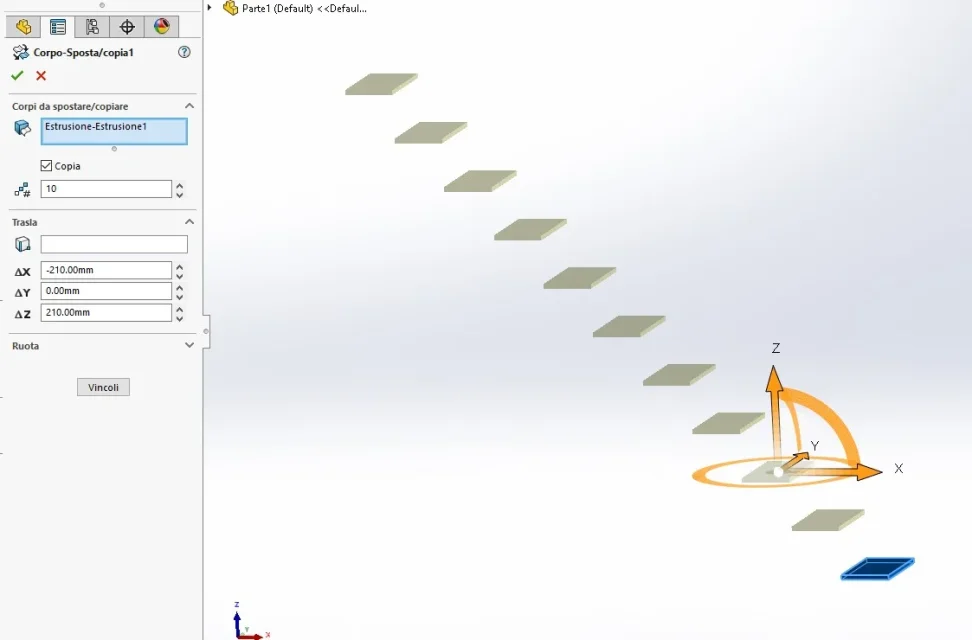

I propose
good alternative idea, the only thing that maybe becomes a little more complex in case the scale is no longer 45°. Thank you very much
then you can do as from attached file. If you don't want to put the quotas by hand, just connect them with equations.
