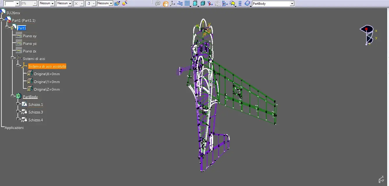

I have a little problem: I can't make sure that the yz plan becomes xy, because I would like to make sure that when I click on the side view the aircraft must be seen sideways and in horizontal and not vertical position.

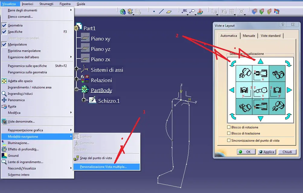

you have two options:
the first is to change the orientation of your sketches through the command (txdx on the sketch, in the comara menu choose object... in the submenù choose "change support".
In paragraphs 1 2 and 3 you can change the plan of sketch, zero of the sketch and oriented towards h and v respectively.
or change the viewpoint by acting on the brakes indicated with 2.

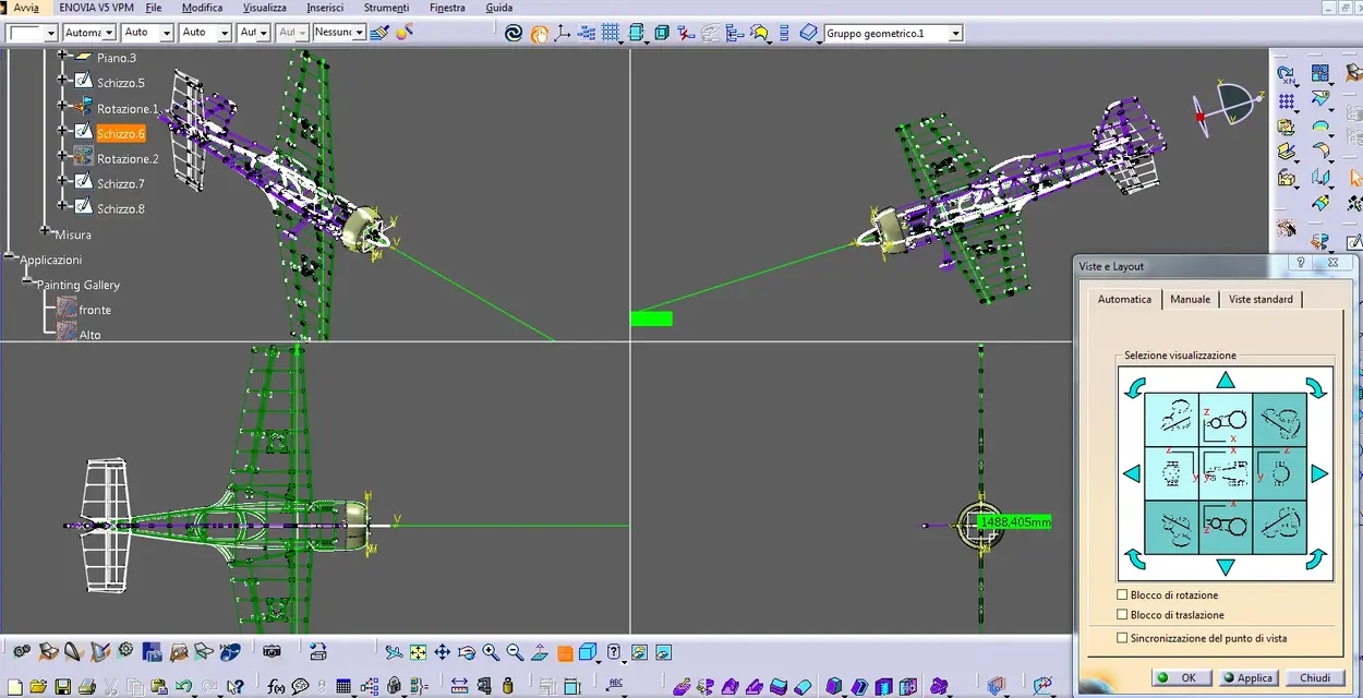

thanks fer, regarding the second solution the z axis continues to coincide with the longitudinal axis. . I probably don't quite understand the images, unclear.
with the first I should make a rotation of 90 degrees with y axis, but I don't know how to do.. I can only reverse the towers, but don't rotate them.. At least. .
with unclear images I was referring to those of the multiple view, not to your fer.
I have not been sufficiently precise.
If you want to flip the view plan according to a given axis you must act on the reverse of the towers.
while actually changing the points of view, it is carried out on the third panel.
