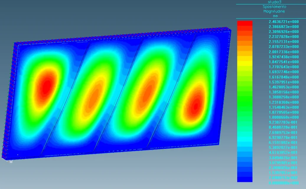

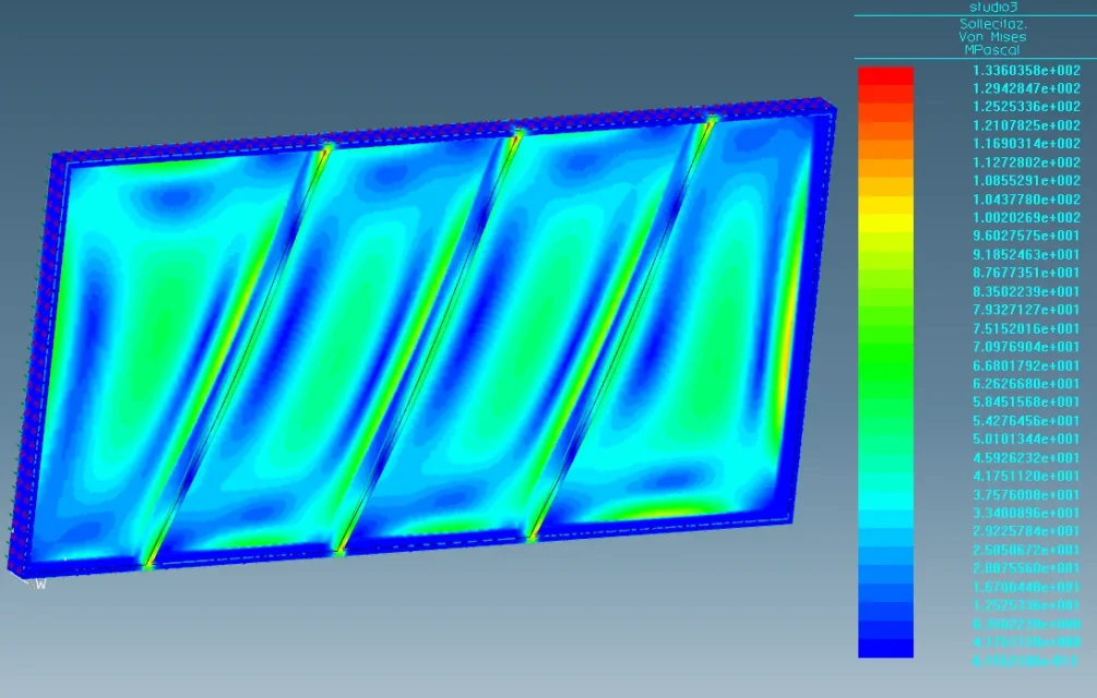

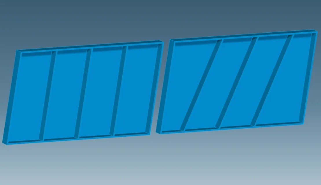

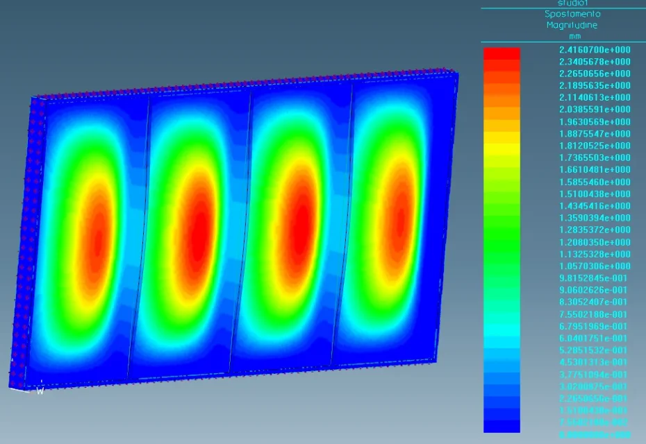

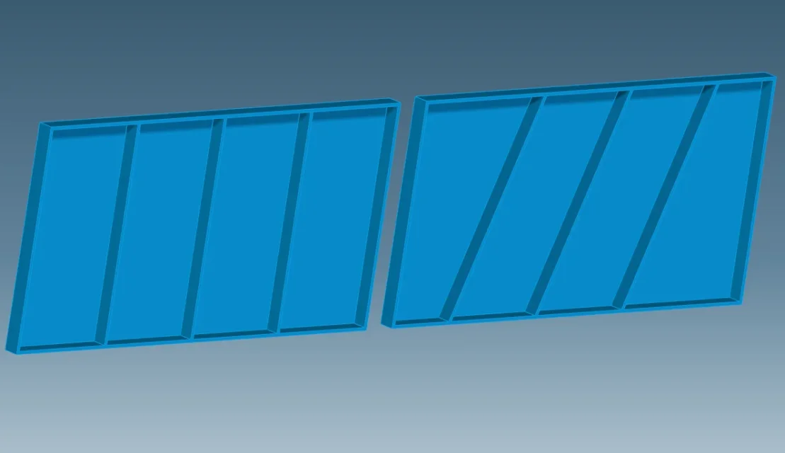

beyond the joke of spirit, it seems that it is an aesthetic choice. I did a test with a sheet having the same material, constraints and load but different arrangement of reinforcements, having the optimal solution is the first with equally distributed areas.- the second study has 20° oriented reinforcements, so they increase the two extreme areas that are penalized, then I tried to tighten them almost equalizing the areas, but the result does not change,Studio_1a.webpStudio_1b.webpStudio_2a.webpStudio_2b.webpStudio_3a.webpStudiop_3b.webp is better the primary solution even if less glamorous.1702913932713.webp

In fact I would have responded that the first did so and then all the others copied them the same as monkeys, without making calculations or analysis.
bho.. I know
I don't want to question the calculations made because I don't have the ability.
but it seems that the choice is not so reductive and tied to the aesthetic aspect.
it would seem that at full load the cassone exerts a force downwards.
This force tends to deform the cassone by bending it downwards and it would seem that oblique reinforcements are better than vertical reinforcements.
I'll throw it there.
But the direction in the direction of travel could be that in the phase of acceleration the load tends to slip back and the oblique reinforcements, in the back zone, are more effective?
