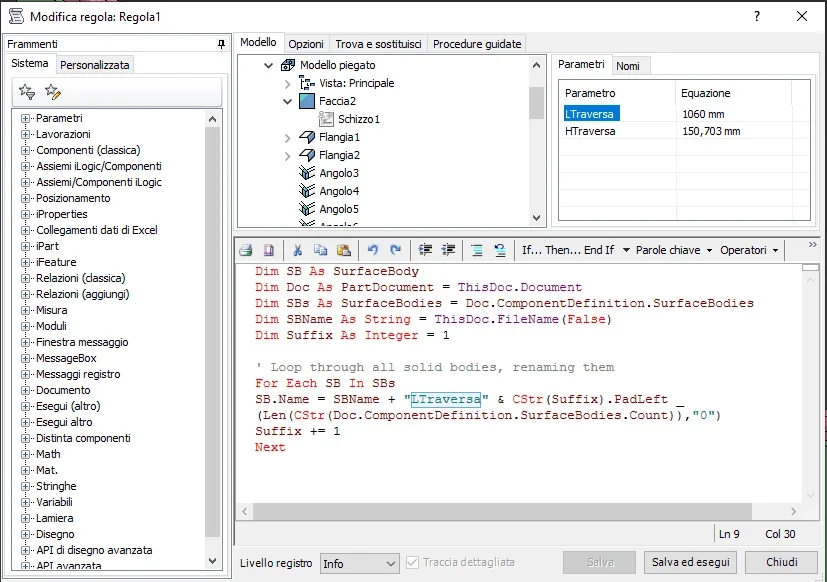

I designed a folded sheet metal multibody, this is a cross-section of lifts formed by multiple components. logically as you can understand lifts are not equal suits, and the lengths of these beams change.
I created a library in the content center where they select the cross and give a measure in length. I would need all the bodies inside the multibody to change name according to the length I gave to the body.
e.g. I insert cross-section 1500, so I would like to find the various bodies renamed in : 001_1500; 002_1500; 003_1500.
whereas if I insert 2000 I will find the components referred to in 001_2000; 002_2000; 003_2000.
Is that possible? I think it's a job to do through ilogic.
I continue to study on it, if I find a solution I write down below.
