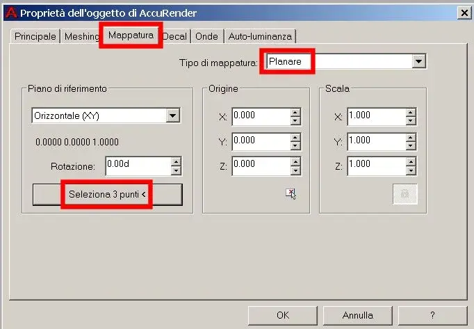

you must "map" every single object whose application of the texture is not standard, in your case you must apply a mapping Planners selezionando con 3 points the reference plan.
i.e. to select in the right order the points that require the procedure.
click on property object, or type _ar4_objectproperties
206.webpdivagative note: typing ar3 after the launch of accurender4 you can use the old accurender interface3. in parer mio (for those who took the hand) reduces by 50-60% the time for the "dress" of the model to render.
solved, you made me discover the object properties accurenders that seem very interesting.
Thank you
