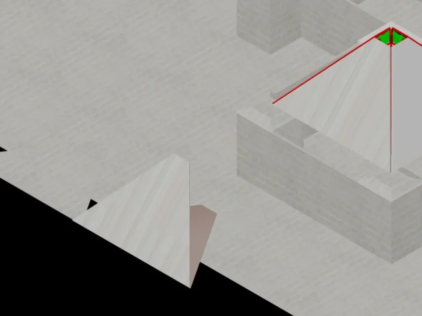

good morning to all I would like to succeed in finding a way to get the rendering of the tilted falde roof that I am making through autocad2010 ... I can apply the textures on flat horizontal or vertical surfaces but not on the inclined ones so when rendering I do not get the desired result. Is there any particular function that can adapt the texture to the layer or could it be a graphic card?
with this command I managed to make the texture fit by turning the gizmo. Thank you.
